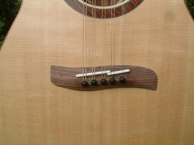

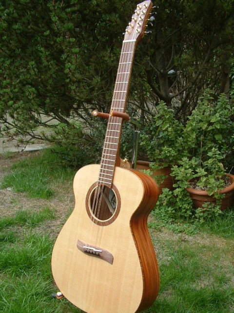

I recently finished a guitar cittern for Gavin Davenport of the band Heckety and documented the build on my website here:
The first things you have to think about are scale length and tuning (this will let you think about string gauges and overall tension) and then the body size/design. I decided on a Grand Concert size (which is close to your OM idea) with 16 frets clear of the body and a 24.9" scale length as that's what Gavin plays.
As for the bridge I went with five holes pinned with each pair of strings in each hole:
Neck design is going to depend on the string tension to some extent.

PostPosted: Sat Sep 30, 2006 12:13 am
Thanks Dave. That is one sweet instrument.
